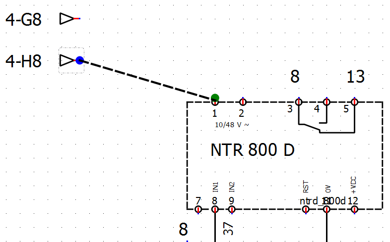

Without releasing, move the mouse up to the end terminal of the conductor.
Once the end terminal is automatically identified by QElectroTech, release the mouse to create the conductor.
Figure: QElectroTech manual conductor creation¶

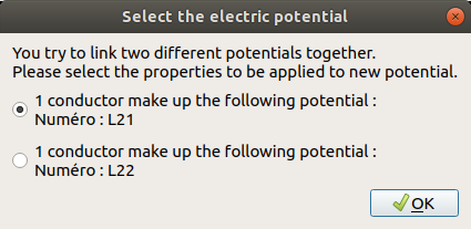

Warning
At the case that the initial and end terminal are different potentials, QElectroTech considers two terminals from the same element as different potentials, QElectroTech will inform by a warning PopUP window. Nevertheless, QElectroTech will create the conductor
Figure: QElectroTech different potentials warning¶
