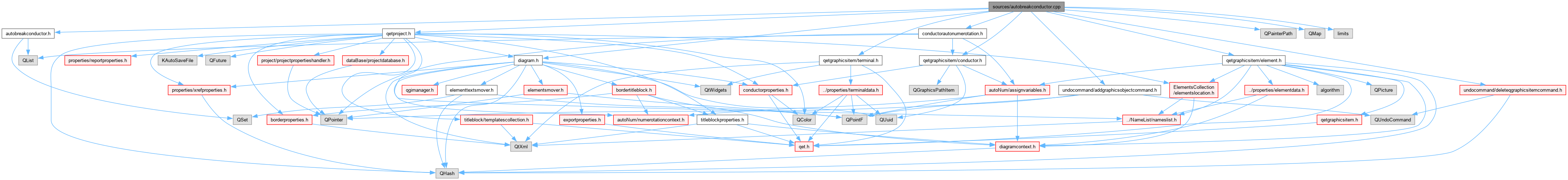

#include "autobreakconductor.h"
#include "diagram.h"
#include "qetproject.h"
#include "conductorautonumerotation.h"
#include "qetgraphicsitem/element.h"
#include "qetgraphicsitem/terminal.h"
#include "qetgraphicsitem/conductor.h"
#include "undocommand/addgraphicsobjectcommand.h"
#include "undocommand/deleteqgraphicsitemcommand.h"
#include <QPainterPath>
#include <QMap>
#include <limits>
Include dependency graph for autobreakconductor.cpp:

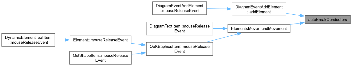

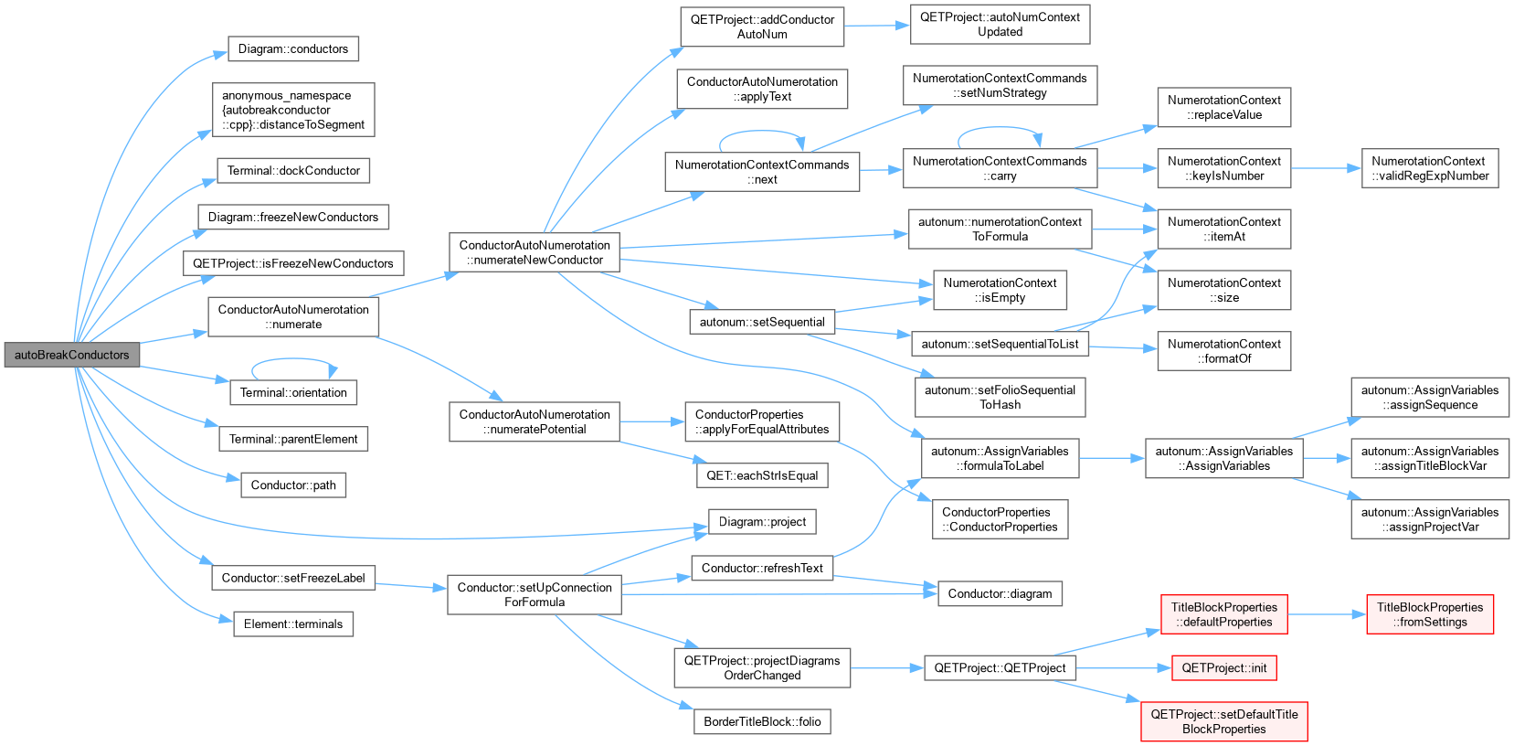

QSet< Terminal * > autoBreakConductors (Diagram *diagram, Element *element, QUndoCommand *parent, QList< Conductor * > &conductors_handled, QSet< Terminal * > &used_terminals)
 autoBreakConductors For each terminal of element, check if its dock point lies on an existing conductor. If so, break the conductor and reconnect through the element's terminal. Broken conductors from the same circuit (sharing the same far-end endpoint) are broken together; independent crossing conductors are left untouched.
diagramthe diagram containing the conductors
elementthe element whose terminals trigger breaks
parentundo command under which break/reconnect sub-commands are created
conductors_handledshared list of conductors already claimed by a previous call in the same batch (prevents double-processing when multiple elements are broken in one pass)
used_terminalsshared set of terminals already used as connect_to or other_terminal in the same batch
set of terminals that were connected to a broken conductor's far-end (useful for preventing duplicate auto-connect)
