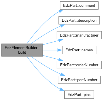

Collaboration diagram for EdzElementBuilder:

Generates a generic symbol: a body rectangle with one west-facing terminal per pin (stacked on the left edge, on the 10px wiring grid), per-pin labels, localized names and the element-information fields QET uses for the BOM. Faithful port of the edz2qet.py prototype's builder.
