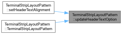

Collaboration diagram for TerminalStripLayoutPattern:

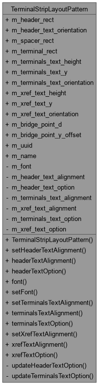

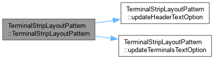

 TerminalStripLayoutPattern ()
void setHeaderTextAlignment (const Qt::Alignment &alignment)
 TerminalStripLayoutPattern::setHeaderTextAlignment Set text alignment to.
Qt::Alignment headerTextAlignment () const
QTextOption headerTextOption () const
QFont font () const
void setFont (const QFont &font)
void setTerminalsTextAlignment (const Qt::Alignment &alignment)
 TerminalStripLayoutPattern::setTerminalsTextAlignment Set text alignment to.
Qt::Alignment terminalsTextAlignment () const
QTextOption terminalsTextOption () const
void setXrefTextAlignment (const Qt::Alignment &alignment)
 TerminalStripLayoutPattern::setXrefTextAlignment Set text alignment to.
Qt::Alignment xrefTextAlignment () const
QTextOption xrefTextOption () const
Public Attributes
QRectF m_header_rect {0,30,50,130}
Qt::Orientation m_header_text_orientation {Qt::Horizontal}
QRectF m_spacer_rect {0, 50, 10, 90}
QVector< QRectF > m_terminal_rect
qreal m_terminals_text_height {50}
qreal m_terminals_text_y {35}
Qt::Orientation m_terminals_text_orientation {Qt::Vertical}
qreal m_xref_text_height {60}
qreal m_xref_text_y {95}
Qt::Orientation m_xref_text_orientation {Qt::Vertical}
qreal m_bridge_point_d {5}
QVector< qreal > m_bridge_point_y_offset {50,70,90,110}
QUuid m_uuid {QUuid::createUuid()}
QString m_name
void updateHeaderTextOption ()

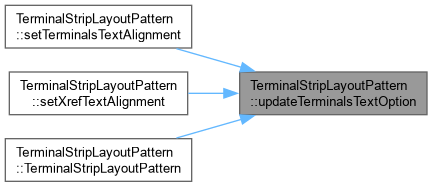

void updateTerminalsTextOption ()
QFont m_font
Qt::Alignment m_header_text_alignment {Qt::AlignCenter}
QTextOption m_header_text_option
Qt::Alignment m_terminals_text_alignment {Qt::AlignRight | Qt::AlignVCenter}
Qt::Alignment m_xref_text_alignment {Qt::AlignLeft | Qt::AlignVCenter}
QTextOption m_terminals_text_option {QTextOption()}
QTextOption m_xref_text_option {QTextOption()}

◆ updateHeaderTextOption()
void TerminalStripLayoutPattern::updateHeaderTextOption ( )
◆ updateTerminalsTextOption()
void TerminalStripLayoutPattern::updateTerminalsTextOption ( )
