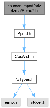

#include "Ppmd.h"
Include dependency graph for Ppmd7.h:
